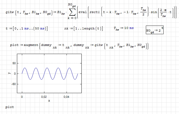

I recently came across a set of MathCad sheets, which I am attempting to extract a small sample; rectified waveform and ripple. As I am trying to reconstruct in SMath, early on, I cannot resolve a few definitions; functions "rect1(...)" and "g1hw(...).
I'm hoping someone can help. Attached is my SMath sheet and the reference MathCad15 files.

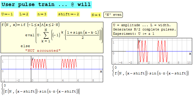

Play with these two ... Jean

... added numerical convolution.
From brushing the *.PDF "pulse" has no limit.
Show some you need for concluding a project.

The function g1hw fails. The comment "k - not defined". Hopefully, the attached pdf of my fist page give you an idea. Pulses and Waveforms work in progress - nas.pdf (129.72 KiB) downloaded 560 time(s).

Hi Norm. Some few notes:
- For speed up the code, you must to put at some places some eval() in SMath.
- Some vectorization are automatics in Mathcad, but not in SMath. Here you can use the index nk instead implicit or explicit vectorization, as shows the picture.
- N0.gc is 2^8, and it is for use as the finite index for fast Fourier sums, but it's too big for SMath. Use something lower.
- T.hw is undefined in you worksheet.
