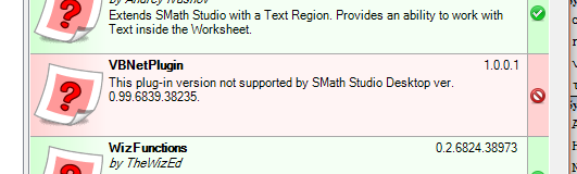

#4 已发布: 2018/10/27 23:00:16
Basile
Basile
8个赞,共172个帖子。
Davide,
This is what I have: It still persists every time I start SMATH.
Basile

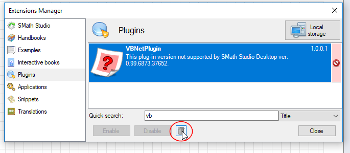

#5 已发布: 2018/10/28 06:01:34
1,443个赞,共2,936个帖子。
you can simply remove it.
#6 已发布: 2018/10/28 12:07:17
1,443个赞,共2,936个帖子。
Fixed, plugin recompiled. The plugin version was tied to a fixed value "1.0.0.1" that was causing issues on update logic.
