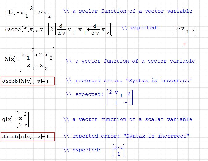

SMath论坛 SMath Studio Bugs & Problems Jacobian not working properly? 1页(3条) Jacobian not working properly? - mb10 - 消息 转到最后一个帖子 #1 已发布: 2013/8/28 05:26:30 mb10 9个赞,共20个帖子。 组: User May be I'm not using the Jacobian function in the appropriate way, but it seems to me it does not behave as expected.See below.EDIT: SMath version: 0.96 - build 4909 Jacobian.sm (9.22 KiB)已下载 1373 次。 #2 已发布: 2013/8/28 08:18:33 Martin Kraska 1,362个赞,共2,276个帖子。 组: Moderator You may consider using the function Jacobian from the Nonlinear Solvers plugin by Davide Carpi. Jacobian_testing.sm (9.8 KiB)已下载 1395 次。 Technische Mechanik mit SMath Studio: https://link.springer.com/book/10.1007/978-3-658-50592-9 #3 已发布: 2013/8/28 09:05:34 mb10 9个赞,共20个帖子。 组: User Thanks. 1页(3条) 有新帖 无新帖
