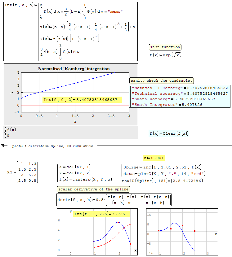

This Smath document is worth 2 pieces of gold:
1. a much higher Smath numerical integration.
2. numerical integration of splines [ainterp]
cinterp => not tested. As it looks, it would
be easy to rebuild the Smath integrator.
Integrate Romberg.sm (52.6 KiB) downloaded 1188 time(s).
Andrey Ivashov 2016/6/17 19:51:00
#2 Posted: 2016/6/18 00:21:01
... [suite] for your tool box.
Includes the scalar plot of 'cinterp'.
Integrate Romberg Int[f,a,b].sm (26.37 KiB) downloaded 1022 time(s).
#3 Posted: 2016/6/18 12:11:13
... the great Smath "Integrate Companion" for your toool box
1. almost 12 decimals garanted
2. integrate the "splines" directly
3. added the "incremental splines derivative [order 1].
Done in Smath 5346 OFFicial release, must be checked latest release.
Integrate Companion [Technical Accuracy].sm (48.89 KiB) downloaded 1130 time(s).

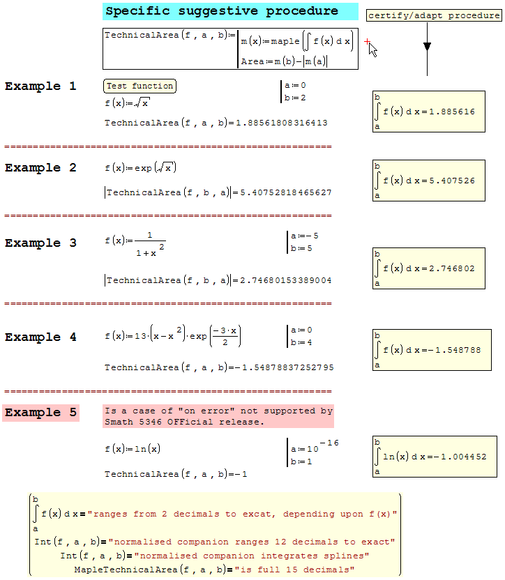

#4 Posted: 2016/6/20 09:33:33
...my collaboration about "Integration" seems to end here.
There is surely a way to universalise the "Maple Procedure".
Hopefully, this Smath document answers all past & future questions.
Maple Procedure will not solve all cases, for instance: if Maple
returns a function that Smath does not have [Polylog, Bessel ...]
the Procedue will fails.
Integrate Companion [Technical Accuracy].sm (99.97 KiB) downloaded 1000 time(s).
