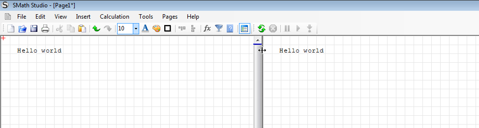

On my 24 'monitor, the calculatesheet is always placed to the left. Is it possible to move the display to the right or center the sheet ?

Hello [userlink]Oktaeder[/userlink],
you can split the view and then use the right panel as primary view.
