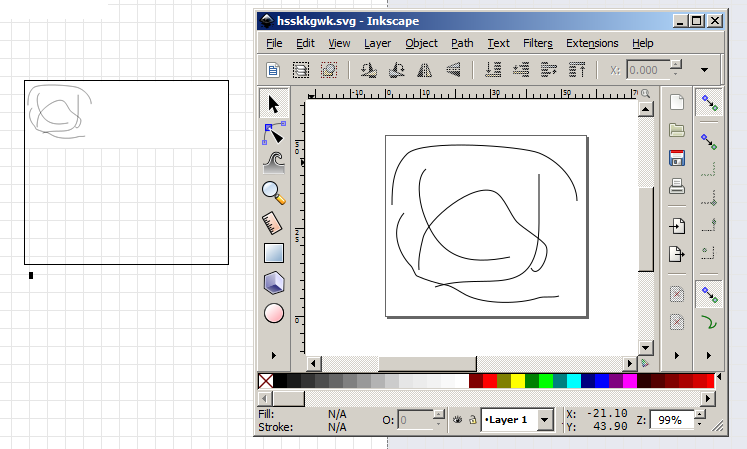

Hi All,
So I need some ideas on how to speed up resizing of .SVG containing Image Region.
Currently this is what happens:
- you drag the regions size marker
- with every increment, the .svg image inside renders itself into raster image for display inside SMath workbook.
As you can guess that takes up alot of compute power and is slow.
Feel free to throw in conceptual suggestions I can use to speed things up

Also blank .svg you can insert into image region from context menu works as intended now (if you use .dll from last archive) ;-)
And why did I spend 6 hours of my time so far on this? I would like easily editable sketches in my calcbooks - modifying vector graphics is much easier than layerless raster image.

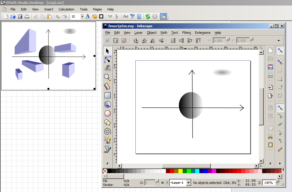

If I open the image in the attached sm file, then some objects are invisible in inkscape. They all were created with inkscape. The reference points of the 3D projection seem to get lost or modified. Could that be a side effect of the size handling?
svg2.sm (28 KiB)已下载 1557 次。
What is the intent of the different behaviour between cloning and copy/paste? Usually, there is no difference, cloning (ctrl-drag) is just a gui shortcut.
I guess that most users would be surprised by the invisible link between the original and the copy. I'd vote for copy/past behaving just like cloning (same image contents but separate file)svg2.sm (28 KiB)已下载 1557 次。
If multiple instances of the same image are required, then still there is the option to have this as external file (export the file and put the name in the placeholder).
#54 已发布: 2016/2/2 13:01:36
1,443个赞,共2,936个帖子。

Hi All, I probably wont get to work on the image region till weekend, however it is a good idea to think of a roadmap. Martin, to discuss your comments:
I have done this - found no file found error annoying as well after some use (new .dll is not included yet).
<1. Insert Image
2. try to switch off the image border in the context menu.
this does not work for me, the border is still displayed.>
Unless I am wrong, this is how original image region behaved (I just redownloaded it), do we want to change that?
I am at the stand still here. The plugin only zooms SVG files if no height/width is present inside the file, or if it is set to % (as I did for blank svg). For either of those cases, when inkscape re-opens the svg, the "3D Box" objects were minimized to the bottom left corner (you still can scale them up if desired). If someone can come up with .svg file that both scales in SMath, and is saved/opened correctly by inkscpe I can use it as a blank document in the plugin. It is not a big deal for me though - how often will you sketch those 3D boxes in SMath?
This one is tricky. While there is no intent, per say, I am not sure how to change it either. You see, I can define Clone () though the code, while copy/paste just takes the region and creates the exact duplicate (just like Davide mentioned). And while you can edit the formula you copy/pasted, you cannot redefine the filename of the image in the region from SMath. Davide, do you think there is a conceptual way to change the name of the imbedded image during copy / paste? I cannot think of one..
Will try :-) update / resize functions are used throughout the code and it will take some effort to seprate the two (i.e. resize without re-rendering of svg, unless certain condition). It should be possible, the question is whether I will be succesful at it.
Also I am getting close to the point where I wanted to be for the Image Region development (once I take care of the above, if it proves to be possible / necessary). Do you guys have any major griefs with it, or suggestions? Otherwise I wil wrap it up and publish to the extensions manager.
