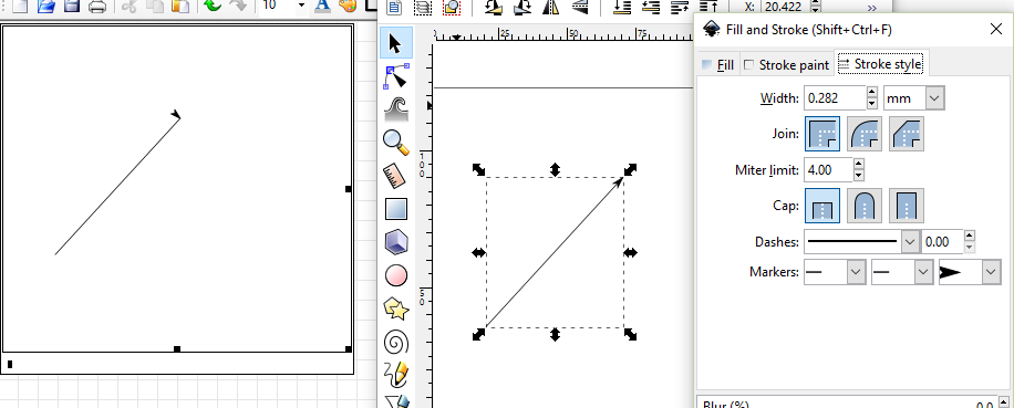

I am not sure if this counts as major grief, but here is screenshot where displayed stroke style is different from what was intended in inksape.
____________________ certainly very annoying:
... missing closure in Inkscape ? ... problem saving from Inkscape ?
... Smath not reading correct ? [doubtful]
Read more: once the object is imported in the image region,
"Reset to original size" ... stretch the right handle to create space.
At this point, if you want to zomm ± : move the bottom handle up/down,
that procedure will respect the "Aspect ratio". I have checked the Smath
image zoom with IrfanView: for photos they are ~ equal quality.

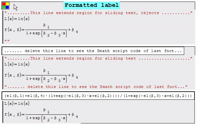

The last brick in the wall about editable region(s) is the "Formatted Label".
Possibly useful for collecting functions of same family, vg: PDF, CDF ...

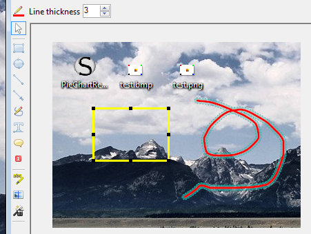

Alexander O. Melnik
Alexander O. Melnik
127个赞,共498个帖子。
Hi all,
Work on image region is complete, as far as I am concerned.
All reported bugs were fixed. File types supported: png, svg, psd, pdf, dxf (partial), dwg (partial).
Known issues:
- it is not possible to set .psd file size. In the code, the blank file types psd, dxf and dwg are inserted as a static base64 string, that is written to a file.
- Pdf support requires large ghostscript .dll files (read further)
Known features:
- Dwg and Dxf support features a clever workaround. Since there is no open source library that will render dwg / dxf, in order to display the CAD drawing you have to export/print it to pdf or png with same filename as original dxf / dwg file. Prints must be placed to either parent folder of .sm workbook, or temporary folder that contains dxf / dwg files "AppData\Roaming\SMath\extensions\plugins\63ddaef8-9a56-4ff6-938e-d590b638bf99" which is default folder when you export from DraftSight.
Lets hunt some bugs before I publish the plugin to extension manager.
On that note, the plugin published to extension manager will feature only .png, .svg, and .psd file types, since .pdf support requires large ghost script library, and dwg/dxf support is marginal and potentially unstable. I will, however, create a new thread which will serve as a repository for complete release of image region plugin.
On a side note, Martin, when you get to release new portable version of SMath plus Maxima, please include full ImageRegion plugin (5 file types) and my excel_io plugin (many thanks).
Note the large archive size due to PDF rendering support.
ImageRegion008.zip.001 (3 MiB)已下载 1620 次。
ImageRegion008.zip.002 (3 MiB)已下载 1650 次。
ImageRegion008.zip.003 (3 MiB)已下载 1692 次。
ImageRegion008.zip.004 (3 MiB)已下载 1659 次。
ImageRegion008.zip.005 (3 MiB)已下载 1707 次。
ImageRegion008.zip.006 (1.26 MiB)已下载 1693 次。
Also download updated ImageRegion.dll ver. 008.5; 008 version contains a bug. (You will still need all other .dll files, except imageregion.dll, from 008 archives above)
ImageRegion.008.5.zip (75.84 KiB)已下载 470 次。
