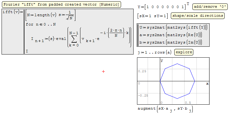

#5 已发布: 2022/4/27 20:24:22
983个赞,共6,866个帖子。
... you may not need the transition.

#9 已发布: 2022/4/28 11:47:25
983个赞,共6,866个帖子。
Dear friends, is there a function to convert a "sys" to a "vector" and a function to convert a "vector" to a "sys"?
There is a good reason to collect a project in system.
You can add/remove ... once collected or at time of collection.
... augment by clicking on the place holder of system.
... push down from top
... insert .
The attached example was collected this way by the Originator.
Simply plotting a zombie parrot from conversion.
At this point, the appropriate adjacency matrix was designed,
resulting in the desired W truss.
Collaboration appointed several visits ... done.
If you have something specific on the design board, let's go.
Cheers ... Jean.
