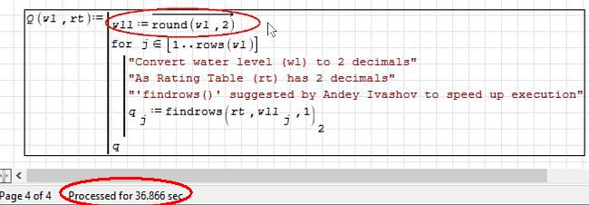

Examples compare speed of execution using Vectorize Operator vs Array Index in Large Matrix Analysis.

Hi. This is the help page for matlab about what their call (in matlab slang) the "vectorization process", instead of the use of "scalar approach" which include for and while loops: https://la.mathworks.com/help/matlab/matlab_prog/vectorization.html
So, scalar = for, while, slow, and vectorial = vectorize in smath, and fast.
Here attached a good demo.
VectorizTest.sm (22.24 KiB)已下载 1379 次。
