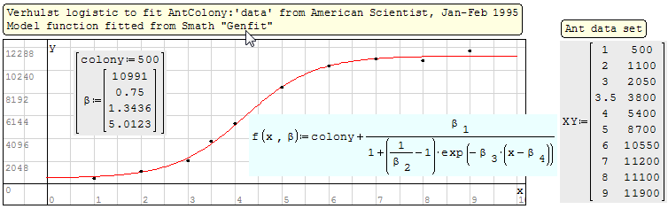

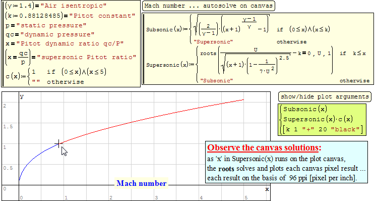

I used Mathcad 8 Pro, 2001i, 11 Single User Edition c/w all Extension Packs [participated
to the design of the DAEP]. May 30 2015, 15:30, PTC canceled their contract with Macrovision.
Since My registered version got zapped and my PC defuntized itself. Fortunately, I still have
11 working from a back2back copy [Extension packs are not working]. In short, Smath replaces
Mathcad for most of the current Engineering works ... except for the parts that were designed
by original Mathsoft [Minerr LM, Adaptive integration, Odesolve wrappe, l_p_c_spline as function,
few more exceptions]. 2D plots aren't as easy to use in Smath but Smath 2D are the finest trace
in the market. Smath does not have 3D matrix plots, but plots implicit f(u,v) vector function.
Smath plots and rotates the Breather ...
If you visit "Samples" conference in this forum, download over 100's Smath work sheets.
You will judge what it can do for you. Mathcad to Smath code conversion is sometimes painful.
Don't go too far away, soon some "spline tool" will be posted, maybe tonight.
Cheers, Jean

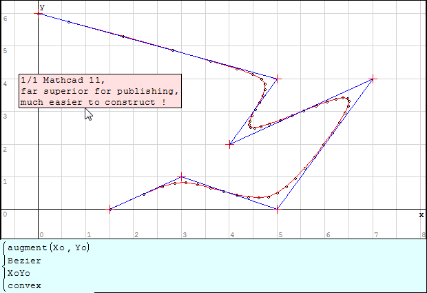

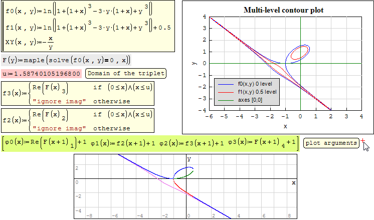

My friend, you will drop dead what Smath can do for you !
Further, Smath Community is very friendly and helpful.
Bad luck: PTC couldn't renew Maple contract. Smath/Maple companions
is the all thing for advanced Engineering/Scientific applications.
Smath is superb for publishing projects. In many respects, easier
to work with than Mathcad was [11 and earlier].
