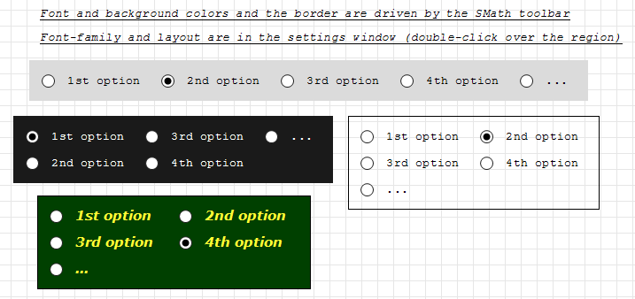

- Allowed inputs: mouse click, mouse wheel, + and - keys;
- Settings: double-click over the region.
- Input: any vector/matrix/system with two or more rows.
- Output: place a variable in the region placeholder.
- Size driven by the values (manual resize not allowed).
- Adds the same control in SMath Viewer (using the same layout).
Look in the attachment for more details and features.

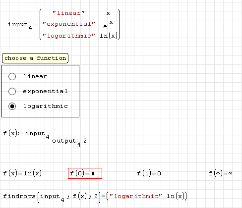

I noticed that when a matrix is taken as input source, the output is no more the selected line number,
but it corresponds to the value for the selected line in the second column of this matrix.
From my viewpoint, it would be preferable to have as output always the selected line number, in order to be able to recover the whole line of the matrix, especially when the matrix has more then 2 columns (!?).
Ok, I can easily suppress this feature, I've just reproduced the combobox behavior

I've updated the plugin, now the output is always the item number; thinking a little while about it, my opinion is that the default output should be this... I'll think if and how to introduce a choice to the output (the ordinal number rather than the whole row or an element in a column...)

Yes, perhaps it is a good idea to have a choice in the settings (radio button?) of what the output should be (row index, column number, where to get the value, complete row...).
Now something different. The discussion on parametrization of smath sheets "from below" caused me to have a closer look on what Andrey calles "absolute definitions", see http://en.smath.info/forum/yaf_postst1348_Absolute-definitions.aspx
If an absolute variable is used as output, then the radio button region fails to trigger re-calculation, even if it looses mouse focus. In contrast to that, normal variables react imediately to button actions.
In order to get the sheet consistent, manual recalculation is required.
I think that absolute definitions could be useful also in the modeller region
Seems a SMath bug or "unimplemented feature"... if you use a classic variable as output (a) and then you define the absolute variable using the output (∼a:a), the result is the same...
I change, by the program, the Input Data source for the Button List and, for every input change, the setting "split every" is reset to the default "all the list"(!?).
ioan92 2014/3/15 12:43:00
