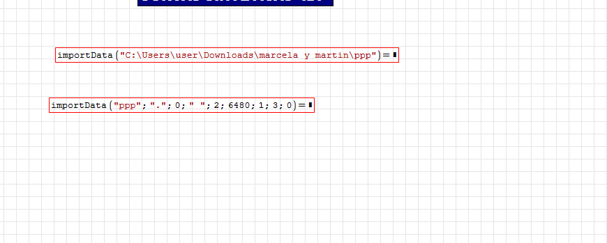

is it possible to import a file in txt to the smath and organize it by columns and rows???

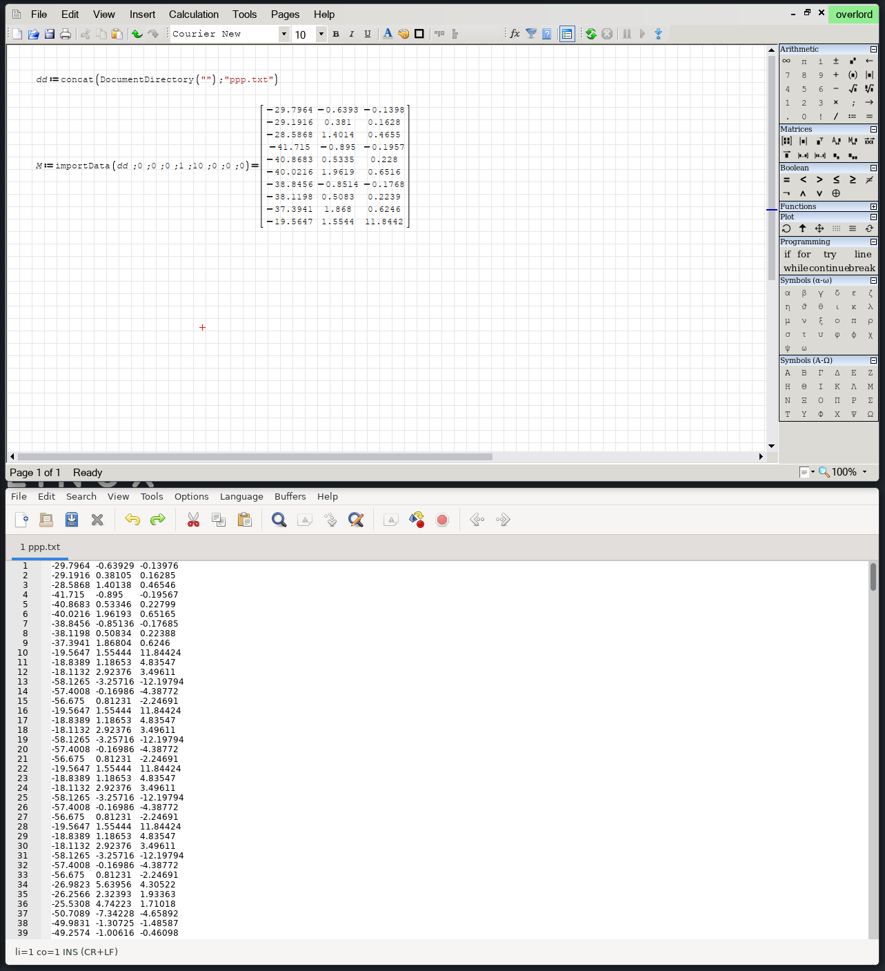

Wrotethis it is the file, thanks for your help
ppp.txt (168.34 KiB) downloaded 827 time(s).
You should write "ppp.txt" where you indicate your file.
You also just have to delete the first line from your data file.
It creates conflict between your function and data.
Data it provides don't match pattern of function.
So in result data can't be read.
Check below.
PS: martin is also right about getting partial data down below.
You can access differently formatted sections by reading them separately.
