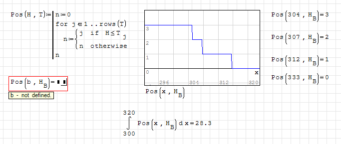

Hello [userlink]MarB[/userlink],
This is because when the numerical evaluation of a condition throws an error (if none of the previous conditions was true) or when the result of a true condition return an error, the function returns itself. When cases() returns itself, acts like a function not yet defined; this makes all his content active and evaluable, therefore when it fails n:j and break are both evaluated and you get the first value of j (3).
The solution is to put the assignments out of the cases(...)' arguments
![2016-12-02 18_08_24-SMath Studio - [cases_in_function.sm_].png](/zh-Hans-CN/files/Download/A3e3yd/2016-12-02-18_08_24-SMath-Studio---[cases_in_function.sm_].png)

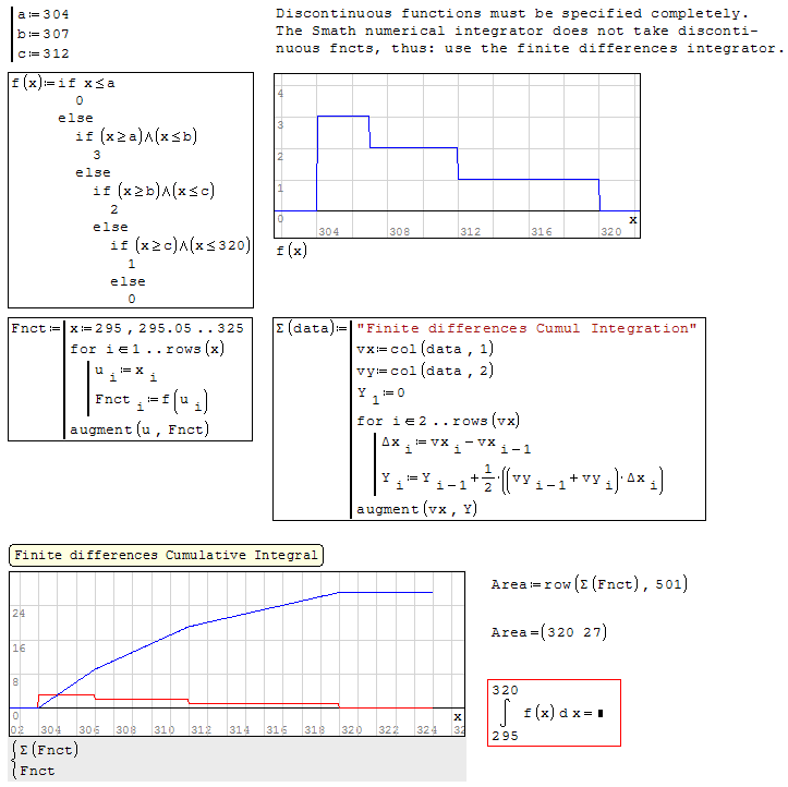

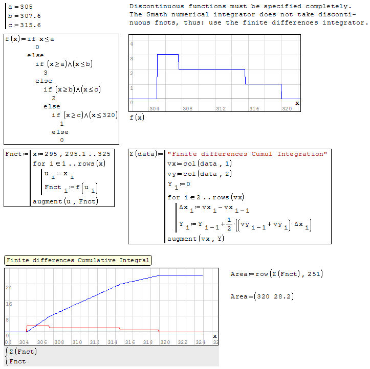

The recursive construction belongs to the "logic ToolBox" as well
as the Bolean [not attached].
Integrate Discontinuous [Algo if].sm (52.51 KiB) downloaded 807 time(s).
is computable in any number of loops and any size. The attached
example demonstrates a typical loop as it will appear in modern
"Programmable Logic Controller". From visible small sizes to
infinitely large sizes [very large sizes] system for controlling
industrial plants. As you can observe, the "nested" is essentially
based on the user 'recipe'.
... same document but the recursive section deleted.
There is "shadow in the context".
Integrate Discontinuous [Algo if].sm (34.11 KiB) downloaded 800 time(s).
