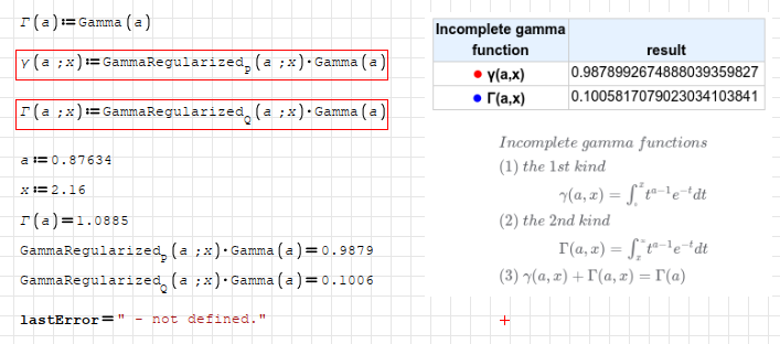

It seems I can't put incomplete gamma functions into user defined functions.
While they are correctly calculated if assigned to a variable or directly inputted,
They give an odd error with "- not defined" when they are in a function.

Hi overlord. Try this please, which prevent the error evaluating the function definition.
#3 Posted: 2021/6/6 14:57:15
597 likes in 1,377 posts.
It works indeed, thank you Alvaro.
I would never thought a line could get around this error.
But why even this error exists? And can it be fixed?
