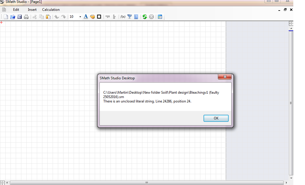

Hi all, have anyone come accross the below problem ? Where the file suddenly says there is an "unclosed literal string" and then all your calculations are lost. Is there a way to recover the original info on the smath file ? This happens mostly when updating the smath..

Hello ddarko,
The file was saved using which version of SMath Studio? There were similar issues in version previous to 0.98, related to images.
To try to recover the file, you might download from the Extensions Manger the "Development Tools" plugin and run the "Smath File recovery" utility (Insert > Development tools > SMath file recovery).
YES with Smath 5346 that has the "File rcovery" as well as your latest version.
It happened once to me and nothing could be done, not even from backup. This
same problem was encountered in Mathcad 11. Don't trust me, but a lost file
is lost for ever. Most probably from unknown bug in the "memory Checksum" at
the time of saving. Differently than Smath/Mathcad, OriginLab backup works
fine and no file can ever be lost, working in background.
Good luck, let us know.

Thanks a lot, with the Development tools plugin I was able to recover the file. Appreciated!
