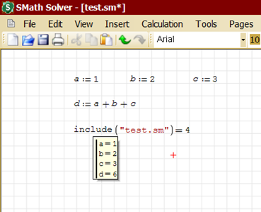

Hi. I think what the user request is a function similar to "clear all" in Matlab.
Given that include is capable of collecting all the names of the variables of a worksheet as the "whos" command of Matlab would do, perhaps the include code can be used to implement the option to delete all the variables with Clear( "all" ) or something similar.
