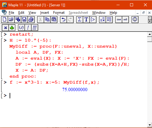

#9 Posted: 2018/2/2 16:57:26
1,106 likes in 1,784 posts.
The problem with your two argument function is that you're using hold() and value() functions in function call and those functions aren't defined anywhere.
uneval (3).sm (10.68 KiB) downloaded 1301 time(s).
Sure, I'm requesting them.
You could also use the method Jean suggests, by calling ...
Jean's method is close, but not enough (actually it's equivalent to x='x' in the image). Can you replicate this Maple's code in SMath?

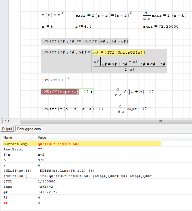

#11 Posted: 2018/2/2 17:57:16
Arie
Arie
94 likes in 285 posts.
Martin,
Are the lines even necessary? What are they doing in your example? I see no difference in not using lines.
#12 Posted: 2018/2/2 18:03:17
1,353 likes in 2,264 posts.
Thanks Martin!
I learned something new today. Looking forward to trying some more of these tricks with line operators in my own applications.
I wish I could explain this.
The debugger doesn't seem to reveal the secret:
frapuano 2018/2/2 18:23:00, Alvaro 2018/2/2 21:07:00

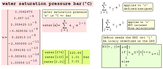

#15 Posted: 2018/2/3 00:08:01
The line is a local definition operator.
Observe the red example: coefficients 'a' exist/defined/assigned
thus satisfy the Σ . On the other example |Σ 'c' result from calculations.
The summing operator must "steal" the 'c' via the isolating local line operator.
Differently but of same nature, DeBoor is redefined locally on the RHS.
More examples have been encountered [there was Legendre polynomials...]

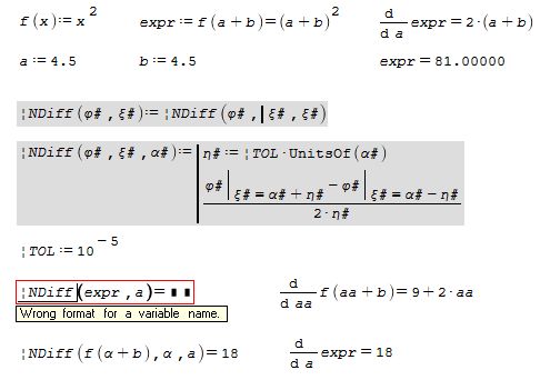

#16 Posted: 2018/2/4 07:08:19
Hi. The proposed method looks excellent, but only works for integers.
So, it's a bug or what else?

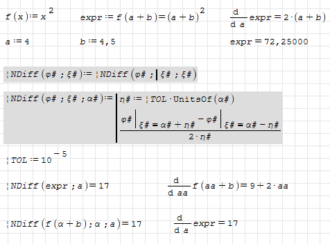

#17 Posted: 2018/2/4 08:47:22
The at() function used for applying the perturbation makes a search and replace without limiting the search expression to valid variable names. It can't, however, handle expressions as replacement targets.
The line function isn't at stake here.
Alvaro 2018/2/5 18:35:00

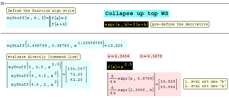

#19 Posted: 2018/2/5 03:05:18
Maybe I don't understand what you are attempting,
if so => here is simple procedure that needs no
Uneval/re-eavl ... it just works on demand ,
wherever demanded in the work sheet.
Maths Uneval.sm (7.66 KiB) downloaded 1281 time(s).
