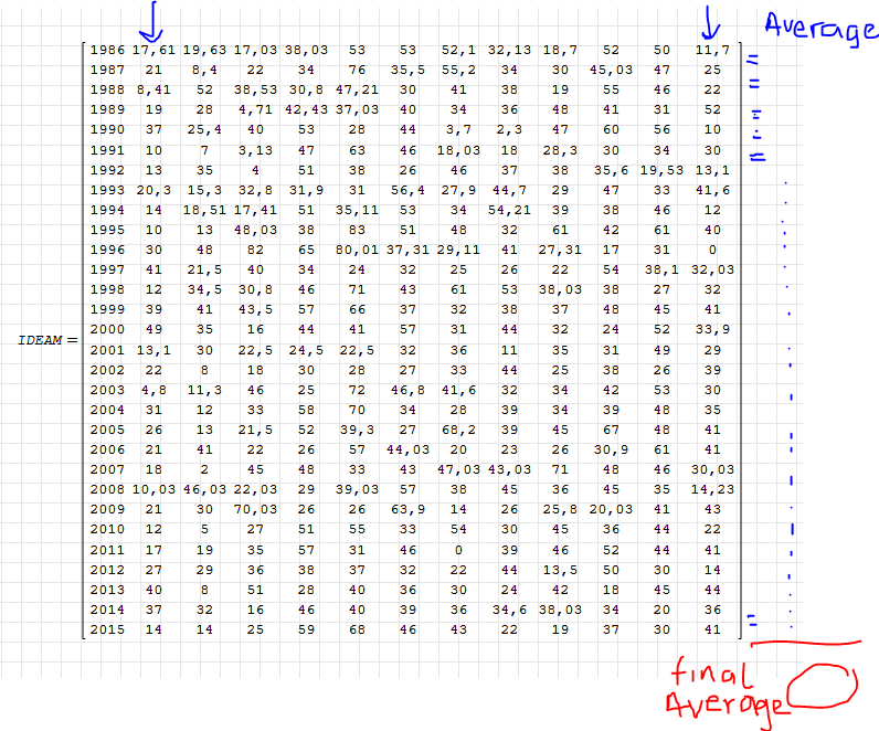

hi...I need find the average of each row (without include the first number) and at the end find the average of all averages....thanks for the help

Had you attached the table ... job done.

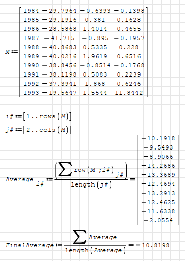

Long version
Short version
#4 Posted: 2021/6/18 08:02:29
Average.sm (9.28 KiB) downloaded 935 time(s).

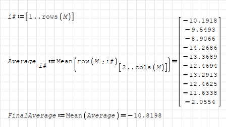

Another version with scalar product.
Easy to adjust to arbitrary subsets of columns.
avg.sm (6.53 KiB) downloaded 951 time(s).
