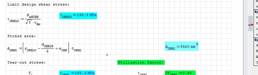

Hello, still quite new to SMath...been wondering why there is red dot error mark on side when all regions seems to be computed correctly?Red Dot Error.JPG

Switch from "Pages View" to "Printing Bounds" (next to zoom slider, bottom right corner)
And see if there are some calculations which not included to gridded print area.

Thx a lot overlord!!!! Solved.
