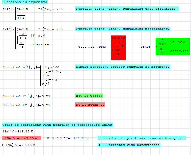

I ran into a couple of issues while running some calculations.
In order to minimize repeated blocks of operations, I found a need to pass a function which contains programming elements to another function or program. It would appear that this is either not possible, or more probably, I am doing something wrong.
I have attached a simplified case that exhibits the issue.
WhatAmIDoingWrong1.sm (9.86 KiB)已下载 1444 次。
Would someone please let me know what I am doing wrong?
THANKS!
-Jeff
P.S. Additionally I found that negative values with temperature units requires parentheses.

Hey I ran into similar before. For one reason or another the built in if() does not work in programming when cases() from plugins does, see attached.
I feel this is a bug, but I would wait for more knowledgeable members to chime in.
P.S.: cases() is more flexible version of if() anyway.
In regards to negative temperature value you more or less answered it yourself. In first case you applied "C" unit to 196 only, while in the second case you have applied unit "C" to (-196). Smath Studio does not differentiate between "-" as an operator and "-" as a sign, so units are applied to the previous number 196 only, unless you force it otherwise. You can actually clearly see to which expression you are applying units if you keep pressing right arrow before you press ' to apply units.
WhatAmIDoingWrongSOLVED.sm (11.99 KiB)已下载 1393 次。

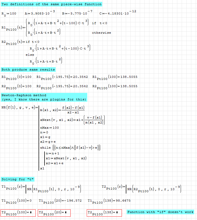

I guess the problem is that Function1() throws an error while his arguments are proprocessed to be passed to the procedure (possible fix: skip the exceptions at this level, if it is consistant). I'll move this topic in bug & problems, though.

Thank you all for your input.
Alex, thank you, I think the cases() function will allow me to work around the issue (with if-else).
I think most of you understand the the problem I presented, but let me try and clarify.
EXAMPLE THAT WORKS AS EXPECTED
Any function containing one or more "NORMAL" MATH FUNCTIONS, can be passed to another function without error.
EXAMPLES THAT PRODUCE UNEXPECTED RESULTS
Any function containing ANY PROGRAMMING CONSTRUCTS, fails to function, or causes an error, when passed to another function.
I'd also just like to add that this one EXCELLENT piece of software! The units handling is a fantastic feature! SO MUCH easier to do engineering calculations than with Excel!

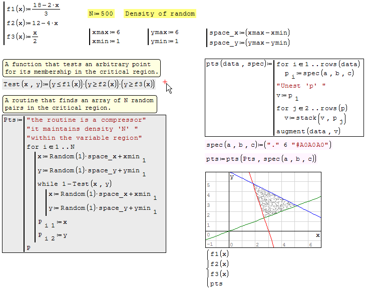

Test(x,y):=(y+y1(x)≥0)*(y-y1(x)≤0)
Maths 2D Plot Constrained.sm (9.19 KiB)已下载 1397 次。
Inst_Segment Partial Random.sm (38.93 KiB)已下载 1385 次。

Note: in the function Pts
you see the 1 in the x,y definitions
and in the while loop, they are not subscript
they are index to explode Random in vector.

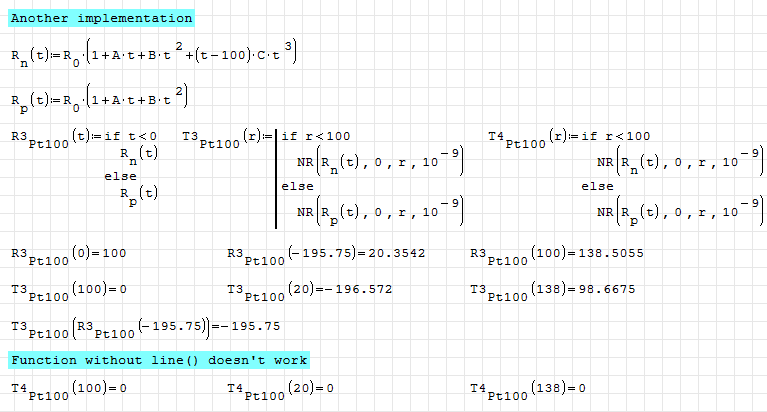

Here is what I was trying to do. I was evaluating SMath Studio using an example I had implemented in other software (the equation for a Platinum RTD and its inverse using Newton-Raphson). I was only sharing my findings of what I *THOUGHT* should work, but didn't. My previous posts in this thread were simplified *examples*. They were not intended to show *real math*, only to highlight what I thought might be an issue. I have since learned that there are a few ways I can work around the issue. So, at this point, it is no longer a problem for me.
Since the RTD equations differ for t>0°C and t<0°C I started with an if() statement. But I couldn't seem to pass that to my N-R function, as shown here (with the cases() solution).
I have since found that I could also implement it as shown here.
In the process of preparing this example, I found that NR() is evaluating to 0, unless the if() statement is within a line() block. Here are the tooltip captures.
Here is the file.
CVD.sm (26.57 KiB)已下载 1382 次。

I was also having some strange issues with my programs that passed functions. Specifically really strange behavior with using ranges in the el() function. However, submatrix() worked just fine. I also had some issues with vectorization. If i tried performing a function within the program, I would receive an error. However, if the program returned the input to the function and I used the same call outside of the program, it worked fine.
I removed any if() statements used in my programs and replaced with cases(). The issues seemed to resolve themselves.
Edit: I'm using 0.98.6128.10018
