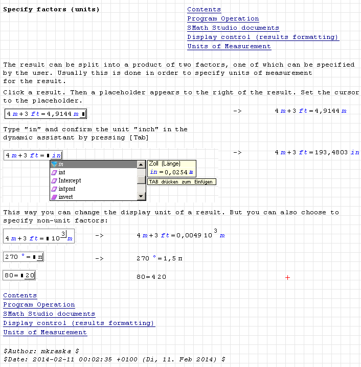

#3 已发布: 2014/3/3 09:15:15
1,362个赞,共2,276个帖子。
You can do that right now.
The attached help page is found in the interactive handbook under
Toolbar [?]> Units of Measurement> Units in Results Display
Radovan Omorjan 2014/3/3 10:13:00
#4 已发布: 2014/11/13 13:23:54
zapzapouch
zapzapouch
0个赞,共27个帖子。
That's just setting the units manually, though. It should be possible to specify the unit as "m", and it automatically displays "10 nm" or "10 km" when the number changes, without manually typing in "km".
