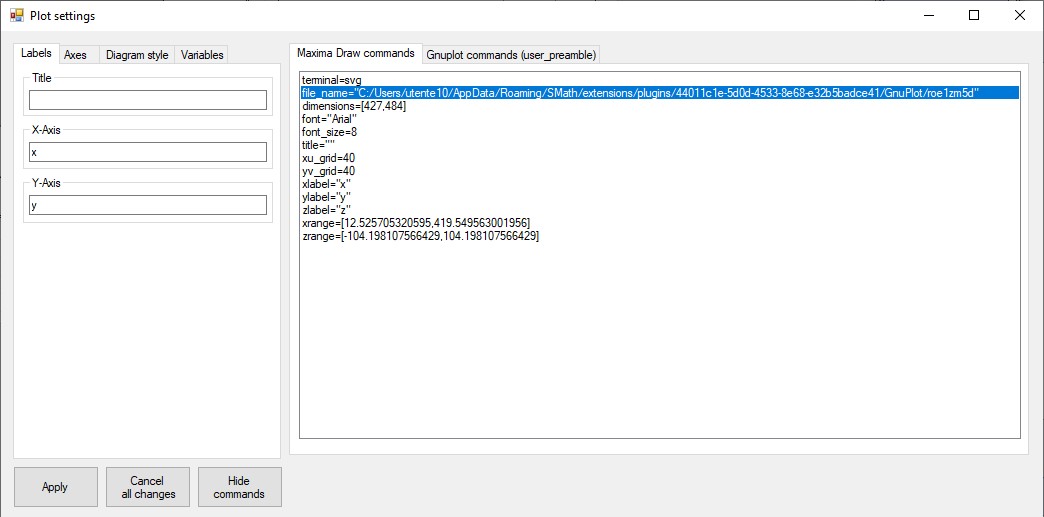

#7 Posted: 2022/1/11 10:20:50
SteelCat
SteelCat
3 likes in 47 posts.
Quote
We have several plot regions, which one are you using?
I'm not sure, it's a spreadsheet made by a friend of mine. It's the one that allows Maxima Draw commands and Gnuplot commands in the settings, if could help...
Physics is like sex. Sure, it may give some practical results, but that’s not why we do it. (R. Feynman)
#8 Posted: 2022/1/11 13:45:11
1,441 likes in 2,932 posts.
It is the plot from Maxima Plugin. I'll see if I can fix it in the next days.
