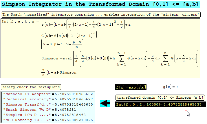

The test function looks naive, it is not so. Ordinary Simpson 7½ D.
Same test function in the transformed domain boosts accuracy to 14½ D.
That would greatly enhance Smath vs competition.

... don't miss the 2nd example ... most remarkable for SimpsonTransform
