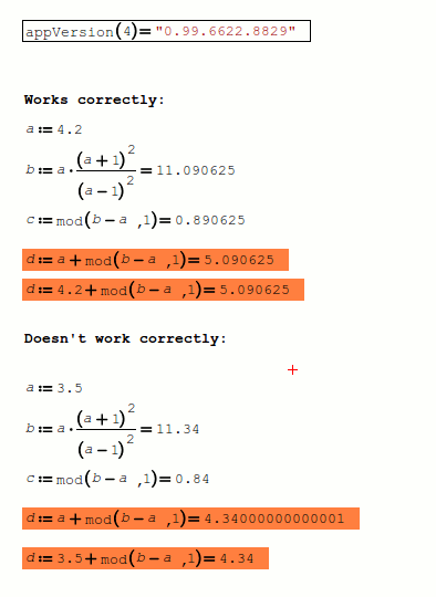

Mod function is not working correctly when certain numbers are added to it.
Most values to be added work ok. But there are certain values that lead to wrong result. Note that the error occurs only when those values are assigned to a variable first, and then added. When they are added directly as numbers the are also OK. What could be the problem?

Thank you for your reply Jean, but I don't understand.
All of the above results are rationals, but only that value is represented as 4.340000...001
And, it is represented like that only when we add some values through a variable.
In any case, it's definetely not equal to 4.34, since problems occur with operations that follow. For example, b - d doesn't give an integer as a result and thus, if you put it as an argument in a function that needs integers as an argument, like Random(), you get an error

Patrick,
You will find infinitely many of such inexact numerical evaluations.
Only integer arithmetic is considered exact.
In numerical maths, not a single function exists, they are all approximations
... approximations wrt the 4 arithmetic operations [+, -, *, /].

Patrick Ps 2018/7/4 06:13:00
Thanks again Jean, I think I get it now!
I'll check whether my problem is fixed if I ask my sheet to use less decimals accuracy.
