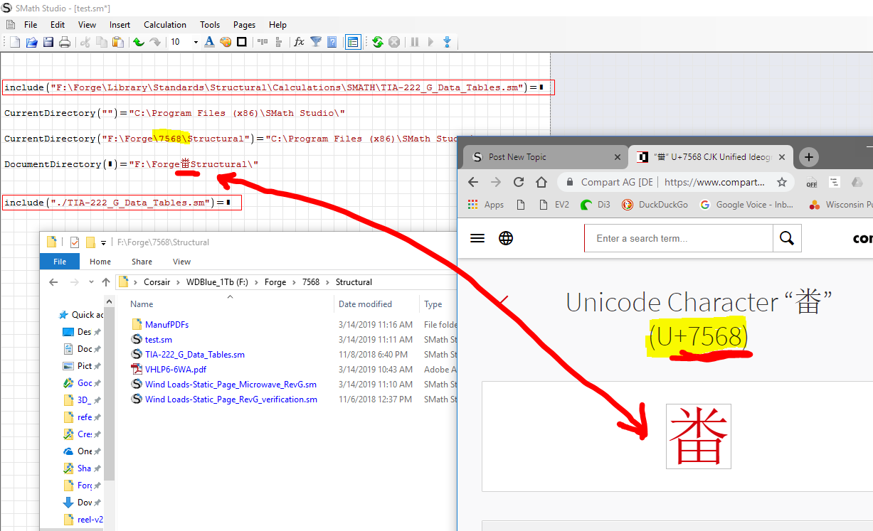

I am encountering an odd error with the newest version- it seems that SMATH is taking part of the path as a unicode formatting for a character.
In my case, 7568 is being read in as a Chinese character. It did not do this before.
I am not sure if this is also throwing of my include statements. I can not read in files I used to be able to.

I am aware about this issue. Will require change of unicode symbols pattern in SS and automatic worksheet correction on opening.
Will be fixed in future SMath Studio versions.

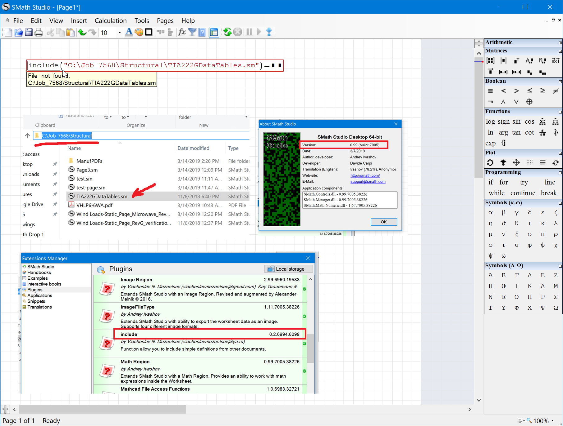

Include_7005-2.pngSo is the include error related or a whole other issue? I tried to simplify the file and file location, see the results below.
I rolled back to build 6894. The include statements work fine in that version.
In 7005, it just can not find the files.
I tried to include the version numbers for program and plugin in the screens.
EDIT: The images were not showing up right. I put them and the attachements inline.
6894 worksheet
7005 include error
Not to sound ungrateful, but many of my worksheets are broken. I will admit to becoming complacent and comfortable in SMath's stability and accuracy. I am in the middle of this perfect storm since i organize things by number and tried to organize my work to point to central library's of files.
I am finding it hard to believe that after a week and ~38k downloads, I am the one who is discovering it. Again, not complaining, but I know that there are many other more capable programmers and users out there.
Dennis

Reproduced. Looks like something broken in Include plug-in. Checking...

Fixed. Please update Include plug-in using Extensions Manager.
