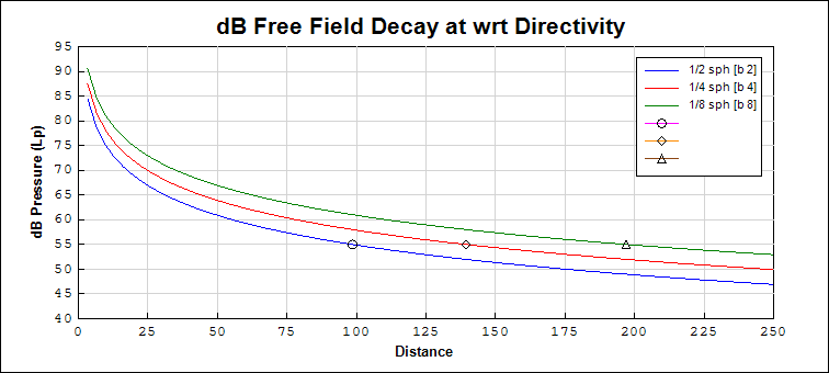

Found the issue(s). See revamped file. Still having issues in that X-Y plot Labels for the legend *zap*Quick Sound Loss.smz (142.28 KiB) downloaded 1484 time(s).
Edit: Two bugs
  1. X-Y Plot. If functions crash, *Zap* to the legend titles. All other titles OK. Legend is empty due to laziness after last 5 crashes
  2. solve(4) did not like trying to cancel units in the denominator of the final function (#dist). As I was adding units to x:0-100 FT and dividing the units meters in the function, the function crashed in the solve block (Just the function, with all values plugged in except for x = vector, so it's a solve(4) issue).
This is one of those sheets where UNITS are huge! The equations are all based off of SI/metric references. Major issue
There is additional documentation and function definition updates. Sanity check the graph x scale (adjusted for feet since I'm in the US). Should be good now
#2 Posted: 2018/4/13 17:23:50
The solve block does not crash the function not a bug.
That it does not compute indicates incorrect setup.
No bug in X_Y, re-edit the series name.
