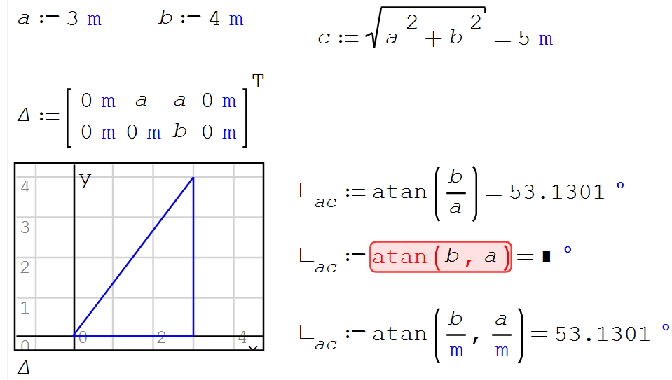

Is it a bug?
atan.sm (6.68 KiB) downloaded 1453 time(s).

It is more a units support not implemented rather than a bug (like said by the error message - "operation cannot be performed with units" ).
