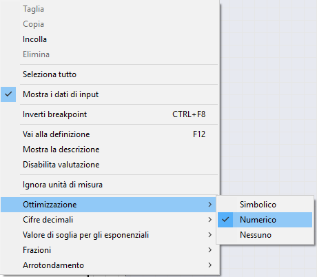

On the other hand, the while loop must be "Numeric" NOT Optimiz
Also, part of the while loop does not like Units.
Would be wise to work unitless.

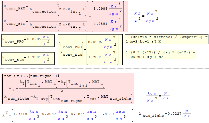

Is there a way to understand during debugging if and why the units are creating the problem?
I know Jean has an aversion to using the built-in unit system within SMath, but I use it frequently without issue. I've not noticed a decrease in performance when using units vs. defining programs to be unitless. I personally think the use of units in calculation is extremely useful in quickly validating general arithmetic and results. Working with units can sometimes be a pain in the sense that when generating equations/programs you may often run into issues where units don't match (and calculations cannot complete) or end results don't make sense. Again, I find this useful in understanding all the different components of the equations/programs I generate.
Work 1rst modular like in the attached.
Most confusing are different but equivalent maths that output different unit system.
What other simple maths will output another/same unit system or "Units don't match".
PROVA CONDUZIONE TERMICA_bkp [0].sm (94.05 KiB) downloaded 841 time(s).

Thanks Carlos for doctoring this project.
1. Refreshed a bit
2. Few more things at the end.
3. "L" is confusing as not explained ... considered "unary"
4. Two pests [in green] wrt to units.
5. The last 4 "clear" removed from program [avoid red]
Wait and see for Originator to comment/complement

#14 Posted: 2018/6/20 16:50:05
Hello Jean
I think there is an error in the internal radios.
Thanks Carlos: my mistake from copy/paste, delete 'm'
Forgot the unit system bug that does not output 0m, 1m.
That bug was reported long time ago, may have corrected in 6671.
Added: Hermite sub-space fillet.
Project PROVA CONDUZIONE TERMICA_bkp_CBG [Jean].sm (390.83 KiB) downloaded 869 time(s).

First of all, going to your contributions, now I see what Jean meant with one of the first replies:
I needed to right click and set the while to Numerical optimization?
Setting my original file this way, makes the loop work quickly (shame on me, I wasn't even aware of such setting...)
Also Alyses hint has helped me to understand that the symbolic evaluation was the problem, and that some different setting should be implemented.

#17 Posted: 2018/6/20 23:16:50
So, in the end, if my understanding is correct, eval() and right-click numeric optimization setting are equivalent, isn't it?
Not so simple !
In the just attached Hermite Polyline, open the first collapsed area.
Observe eval(,) in the subspace module, this is a case of local definition.
#18 Posted: 2018/6/21 13:18:42
... Data Table added. No problem to construct and display.
Couldn't reduce the height of the two first rows ... Ah !
Project PROVA CONDUZIONE TERMICA_bkp_CBG [Jean].sm (402.64 KiB) downloaded 890 time(s).
