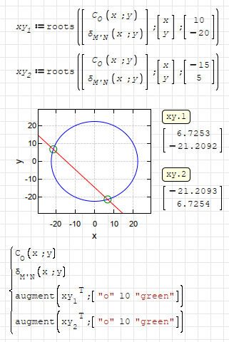

#3 Posted: 2023/7/20 10:10:03

Good! You tell me that there are two solutions. I agree! But in this case the roots(2) function should mention them as such. In addition, the other intersection has coordinates x=-6.72537 and y=+21.20924. As a result, I (as a technician with a specialty other than mathematics) am confused. I understand that the other solution, I have to enter it from the console, in the case of a complicated and automated calculation?! My request is that you show me another method of calculation, which will offer me a solution automatically applicable to the case in question. Automatically, meaning without my intervention from the console.

#5 Posted: 2023/7/20 10:57:17
roots(3) solves intersection(s) of two symbolic differentiable functions.
Initialize wisely the third argument of roots(3)

#7 Posted: 2023/7/20 11:32:29
597 likes in 1,377 posts.
This is why we have roots(3).
Solving without plotting is bad exercise.
You may have full, correct and single answers without guesses for some equations.
But sometimes you are gonna need to plot equations, find intersections and their coordinates.
If you determine good guess points, it will show you nearest results to that coordinates.

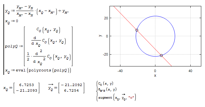

#9 Posted: 2023/7/20 16:42:03
1,106 likes in 1,784 posts.
Hi Nicolas.
Not in this case, because SMath's solve is a numerical procedure. You can demand that of maple's solve() or Maxima's Solve() .
Not that fast ... the values for x are +6.7253 and -21.2093.
Although I think that overlord's solution shows the correct solution, this other method does not require initial values, since it makes use of the knowledge that the solution implies a quadratic equation, assuming that the line M'N is not vertical .
Sophism.sm (35.61 KiB) downloaded 1342 time(s).
#10 Posted: 2023/7/21 02:19:38
Nicolae Olaru
Nicolae Olaru
1 likes in 115 posts.
Not that fast ... the values for x are 6.7253 and -21.2093.
The form in which the result of the roots(2) request is presented is as in the attachment. I thought (!?!?!?) that the elements of the vector represent the results x and y, respectively.
#11 Posted: 2023/7/21 08:31:00
Nicolae Olaru
Nicolae Olaru
With a suitable pair of guess values, the problem will always indicate the pair of variables of the considered point, as can be seen in the attachment. Thanks for the guidance.Image_.png
