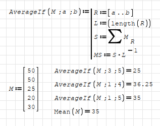

#4 已发布: 2023/12/28 16:04:11
600个赞,共1,381个帖子。
This is another way.
AverageIf.sm (5.16 KiB)已下载 1609 次。
NDTM Amarasekera 2023/12/28 17:38:00

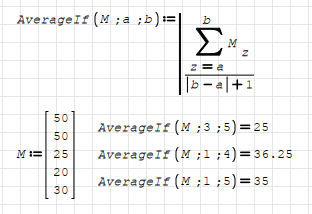

#5 已发布: 2023/12/29 05:55:40
Fikret Atalay
Fikret Atalay
2个赞,共24个帖子。
Took me a couple of minutes to wrap my head around this one, but now it makes sense.
Thanks!!
#6 已发布: 2023/12/29 06:19:06
600个赞,共1,381个帖子。
This maybe an easier way.
NDTM Amarasekera 2023/12/29 09:03:00
