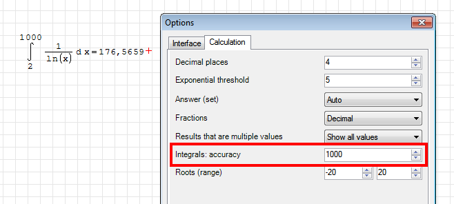

The integral of 1/(ln(x) with limits of x from 2 to 1000 does not agree with mathlab or maxima --
The numerical value of the following integration is off -- should be 176.56 and Smath gives 177.1
Any idea what could be the problem?
Thanks
Joey Ooi
#2 Posted: 2017/5/22 18:50:40
1,441 likes in 2,932 posts.
Hello [userlink]Joey Ooi[/userlink],
You have to set a better accuracy in the global options (tools >> options >> calculation)
#3 Posted: 2017/5/22 21:32:54
Joey Ooi
Joey Ooi
0 likes in 4 posts.
Thank you for your quick and accurate response Davide.
It was very helpful indeed.
Joey

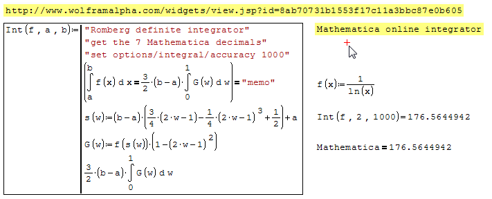

#4 Posted: 2017/5/23 07:53:55
Smath Simpson iterative integrator is known to range from
exact [sometimes] to poor. Increasing accuracy is fine in
this example but will not converge in other instances like
in the Fourier Quantum double integral. You can rescue
your example using the attached Romberg.
Mathematica online integrator link added.
Integrate Mathematica.sm (9.92 KiB) downloaded 1001 time(s).
#5 Posted: 2017/5/23 08:37:48
... revisit same work sheet for the 7 decimals !
Integrate Mathematica.sm (10.19 KiB) downloaded 971 time(s).
#6 Posted: 2017/5/23 08:53:58
... like this
#7 Posted: 2017/5/23 14:32:33
How many numerical integrators have been imagined ?
1+1+1+... Even Mathcad aren't so easy to deal with.
This visit is worth the time spent.
Fourier Quantum CoC Model.sm (36.72 KiB) downloaded 979 time(s).
