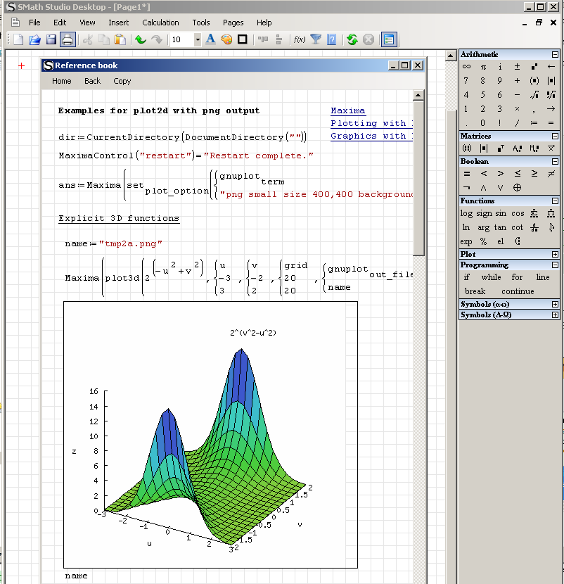

This is what I understand can be done in the current version:
Installation of the interactive handbook
- Open the extensions manager (Tools> Plugins or Help> Examples ...)
- Select the "Interactive books" entry in the list of items to manage.
- Switch to "Online Gallery"
- Download "SMath Studio Handbook"
- Select "Use by default" switch.
Access to the interactive handbook
- Press the ?-button in the tool bar or use Help> Reference book, then a new window pops up, showing the title page.
- Enlarge the window (the book is formatted for standard SMath window)
- Use Ctrl-click to navigate, you can edit but not save.
- Special buttons [Home] [Back]do not work, [Copy] works.
The attached screenshot is done with the Maxima plugin from SVN installed. This shall be released to the gallery tonight.

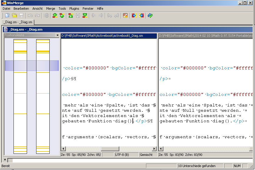

There is a formatting issue in the interactive book.
Andrey, something happened to the line termination characters. This seems to irritate the text region. Also, some math regions changed size, but that does not seem to be problematic.
See the text formatting in the attachment. The original version has a german SVN time stamp, your version has a russian one.

This happens when the text region contains line feeds. Because the files produced by Andrey contains both carriage returns and line feeds, I suppose is a problem related with the text editor that has used. (A file generated in UNIX systems looks like the first shown here)

Problem resolved. I reproduced the changes made by Andrey using FAR. Both PDF and interactive handbooks are now up to date in the online gallery.
