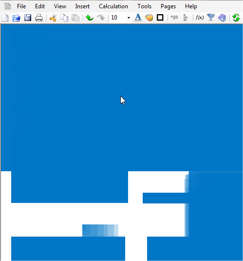

plotting a golden spiral, I've found an issue related to the plots... setting the variable "loops" greater than 9, SMath crashes.
Seem related to the x and y values, that can not be set beyond a certain threshold (approx the value of [MATH lang=eng]2.33*10^8[/MATH] cause the crash)

I can confirm that, as well. At loops=10 everything disappears and by trying to select anything it produces blue background like in your picture. At loops=11 SMath crashes.
