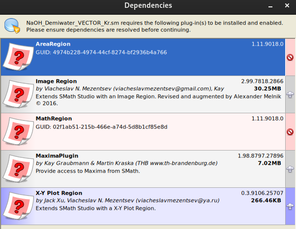

If Maxima is an option for you, then you can entirely automate the production of plots.
For an overview on available plot objects and options see SMath with Maxima.
In X-Y Plot, you can use geometric objects to create the lines and perhaps also a legend.
BTW, there is no point of naming the variable Load.kAmp, because the value is converted to A anyways directly upon storage, unless you just store a number, bypassing the SMath unit system. When you retrieve numerical values, you decide what units to use, independently of what was originally used to specify the value.
![2024-12-15 17_20_47-SMath Solver - [NaOH_Demiwater_VECTOR_Kr.sm].png](/zh-Hans-CN/files/Download/Hn75yo/2024-12-15-17_20_47-SMath-Solver---[NaOH_Demiwater_VECTOR_Kr.sm].png)
NaOH_Demiwater_VECTOR_Kr.sm (208.46 KiB)已下载 1823 次。
