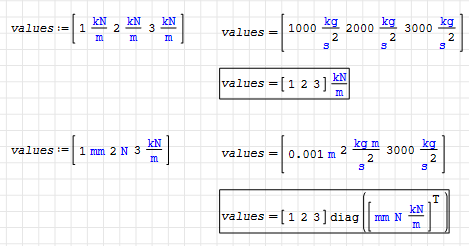

... I was able to convert mm to m (my database has plain values, but they are supposed to be mm). But next step is to display final results in kN/m, but I keep getting kg/s^2. ...
Hi. Something like this?
My guess is his data is something like this.
That's what I deduce from his description at least.

#8 Posted: 2023/6/12 05:29:17
1,441 likes in 2,932 posts.
You have to customize the result units in the rightmost placeholder.
sergio 2023/6/12 05:44:00
