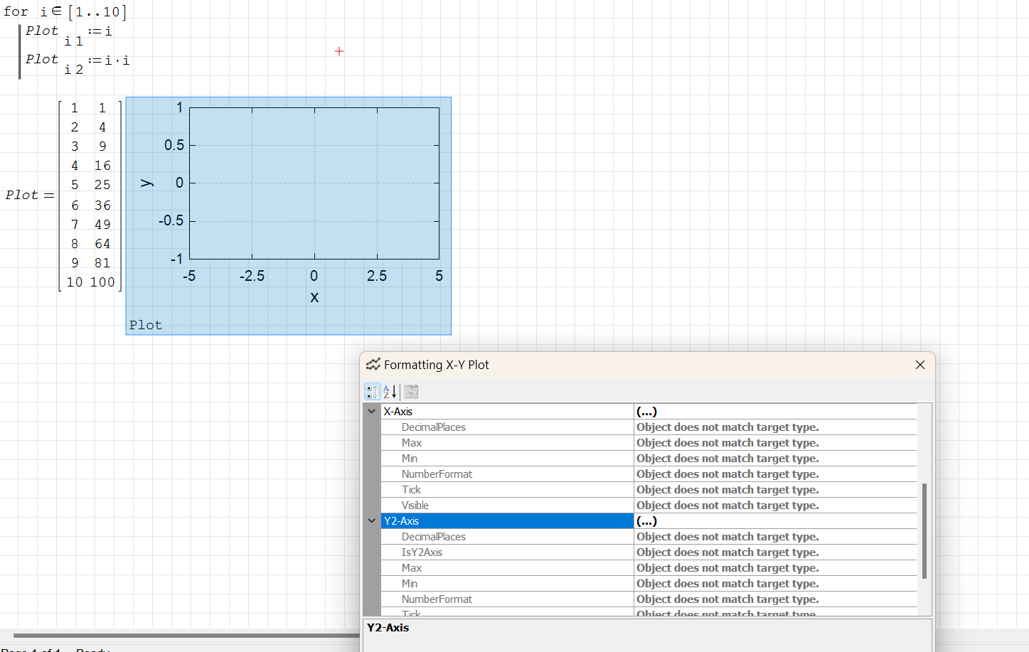

I have just tried to use Smath, after a break of two or three months. I can't get the x-y Plots to work. When I try to adjust the scales, etc, from the defaults, I get the message "object does not match target type" in most/all sections.
I checked with an older file that used x-y Plots - the plots displayed properly, but I still got the same messages when I tried to access the scales, etc.
When I launched Smath yesterday I was offered a new, updated version - I accepted - was this a mistake, has something changed?
Any help would be gratefully accepted.

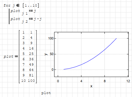

Is this what you mean?
Jon
Windows 11 Home
未找到文件。未找到文件。
Jon
WroteIs this what you mean?
Yes.
The problem may be related to the fact that you don't have the required version of .Net Framework installed. Usually the current version is sufficient, but the component itself is developed using an older version (.Net Framework 2.0). Try checking or installing version .Net Framework 2.0 or 3.5 for Windows 11.
It's strange that the component worked on the same machine before. Others have no problem because they are most likely running older versions of operating systems or have the required versions of the .Net Framework.

The XYplot.sm file works and displays fine, but I still get the "object does not match target type" message if I try to format the plot.
