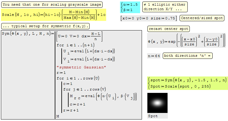

#8 Posted: 2023/3/12 19:33:26
Imaginary 'i' is pretty universal.
Very many Smath advanced functions are coded on that basis.
They will certainly not recognize 'j' ...
As well, 'i,j' are largely used by Smath original Designers
and the Smath Community as rows/cols indices.

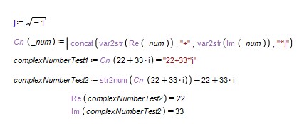

Next: define a function, similiar to this:
Cn(_num):line(concat(var2str(Re(_num)),"\002B\",var2str(Im(_num)),"\002A\\0027\j",1,1)
With this defined at the top of your sheet, you can display your number (as a string) in the syntax you desire. To use it as a mathematical expression, just use the str2num() function to convert it into math. NOTE: for this to 'work,' you need to have the 'Custom Functions' plugin installed:
May this be of Good Help!
- Kenny Lemens, P.E. ᵂᴵ
