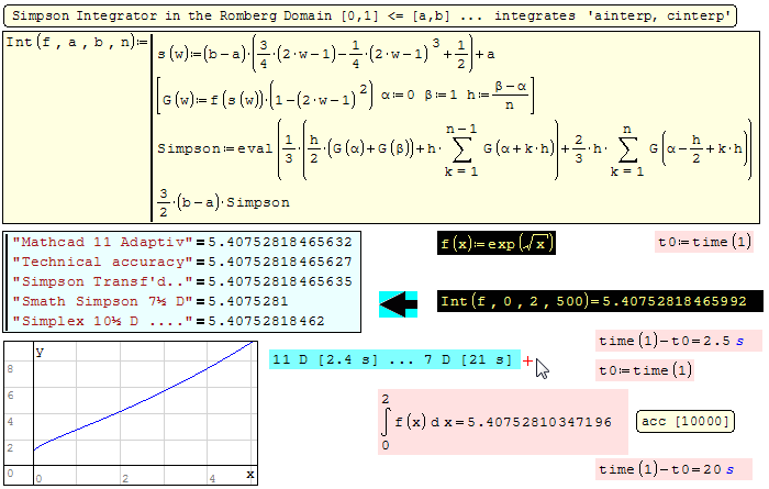

This test function is enough to drop dead on the failure of ordinary Simpson !
The Simpson-Romberg integrator will help your project survive.
The naive look of a function is no indication of easy integration ... Ah !
