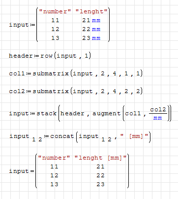

Hmmm, in my special situation it would also work if I could change the global standard unit "lenght" from meters to millimeters. Is this possible? (and if so, how?)
I don't know, but I can suggest you a compromise (see the attachments)
regards,
w3b5urf3r
P.S. here there is a little trick to automatize the unit replacingin in the attached script.
regards,
w3b5urf3r
