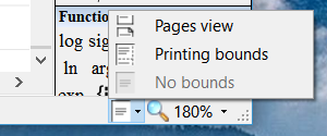

Hi Jon,
You can choose the printing option: "No bounds"
from the right side of the page bottom:
In this way you can settle your work as you want.

Thank you Ioan, that's exactly what I need.
I'd never even noticed the bit at the bottom RH corner. Sometimes I get the feeling that one can do a lot in Smath, but it's a bit like an MI5 puzzle to find some things!
Thanks again.
