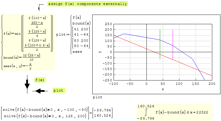

https://i.imgur.com/nbYH2lr.png
2D Plot Discontinuous [min(,)].sm (27.31 KiB) downloaded 762 time(s).
Wrote... Dichotomy added for solving in the complex region.
filling the loft added.
2D Plot Discontinuous [min(,)].sm (44.7 KiB) downloaded 774 time(s).
