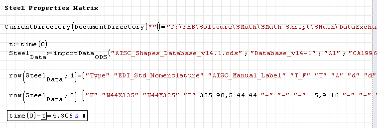

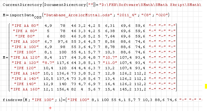

Just change the optimization (right mouse button menu) to numeric. Then reading in the sheet takes 4 seconds on my computer.
See here for details.
