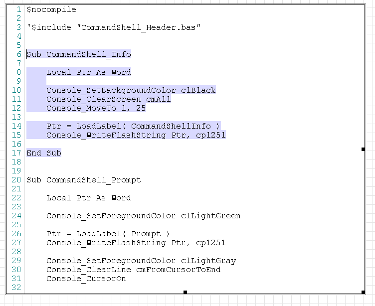

Memo control based on Regions.Control and FastColorerTextBoxCF. Used as an example of the region without a place holder.

引用
It reacts at the font size changement but it seems adapted only for font size 10 ?
You can change font with mouse wheel and Control key when region selected.
引用
In the source that you had indicated it seems that the fonts and the colors (text and background) can be handled (?).
This is not entirely true. Component has no internal data to store information about the properties of the text. Syntax highlighting is performed on the fly. You can not arbitrarily change the color, etc. The only thing what you can do - create highlighting rules.
引用
Is it imaginable to control this propeties in a similar way as in Davide's plugins (buttons, combobox etc.) ?
I need to see this. If you talk about the properties of the text, as I said above can't modify them.
