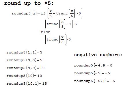

Hello Destory,
Apart from the Ceil function, you can write your own function for this, i have made an example for you:
you can edit the function (extra if loop) if you want it to handle negative numbers differently.
ceil_and_roundup_to_5.sm (7.7 KiB)已下载 2230 次。
I hope this helps you.
regards,
csb
regards,
csb
