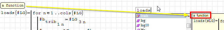

I use #var for "local" variables, so any other variable is "global" (loads is not only function of LG, also of LF.DL etc...); I strongly suggest to use some trick like this, for a fast and easy debug/maintenance (you can use #var _var `var Var VAR or whatever is the best way for you... to add the # symbol before the word, write the word and then move the text cursor to the first character and place the symbol)

P.S. the dynamic assistance show you that loads is a function; however you can set a description text to point out this fact.
![2014-05-09 01_05_07-SMath Studio Desktop - [Beam - Uniform - Multiple Beam.sm_].png](/zh-Hans-CN/files/Download/kp52QF/2014-05-09-01_05_07-SMath-Studio-Desktop---[Beam---Uniform---Multiple-Beam.sm_].png)

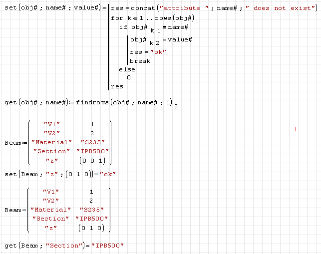

WroteI'm wondering if I could apply the concept of functions to 'function' as "engine pages" ...
Basically I have a bunch of different input that I can send to the function multiple times on a page. hmmmm....
This would work. The disadvantage is that you cannot use ordinary SMath sheets as function descriptions. Instead, you have to write sort of
program (using the line() operator) to do the job.
Before designing the functions you perhaps might consider to define
- the problem data structure and methods to apply to this data structure
- methods data structure like tables, only accessed within the methods
Both structures can be just global variables or single complex objects. You can fake objects with named attributes by using a 2-column matrix with name strings in the first column and whatever object in the second column and define a corresponding set(structure,name,value) and get(structure,name) function pair.
Functions can provide return values and can modify arguments, if these are given as names (call by reference). They cannot modify global variables (any assignment to a name which does not occure in the formal parameters list creates a local variable, shadowing global objects of the same name).

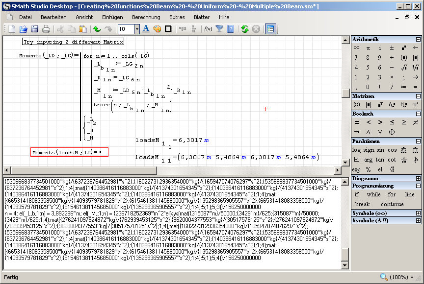

One quick question -
I tried to update my previous post to include moments but seem to be struggling to do so.
I've attached the calculation and hope you can make sense of it. I'm not sure why I'm receive these errors.
Also what is the output window for?
Thanks again!
Creating functions Beam - Uniform - Multiple Beam.sm (48.56 KiB) downloaded 1165 time(s).

The problem is in the mismatch between data structure and indexing. You have a vector of row matrices and try to access the elements just as in a matrix. You have to use nested index levels.
The output window displays the output of trace(), a function for debugging, explained in the wiki

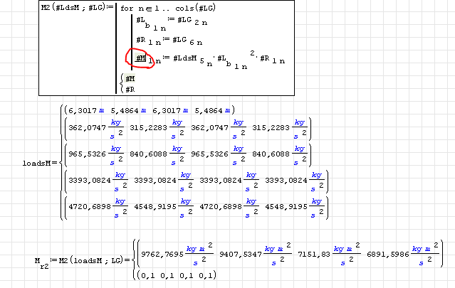

There is one interesting error however which is that it returns one of the matrices as undefined (see attached).
Thanks!
Creating functions Beam - Uniform - Multiple Beam.sm (72.2 KiB) downloaded 1231 time(s).
WroteThere is one interesting error however which is that it returns one of the matrices as undefined (see attached).
Thanks!
You are victim of bug SS-40. Andrey has marked it as fixed but did not yet roll out the fixed version.
You can identify such problems by setting the cursor on some name and watching if all occurences of that name are highlighted in the expression. If not, then there might be a typo or a hidden empty text index.
See the marked spot in the attachment and compare this to your original file.
