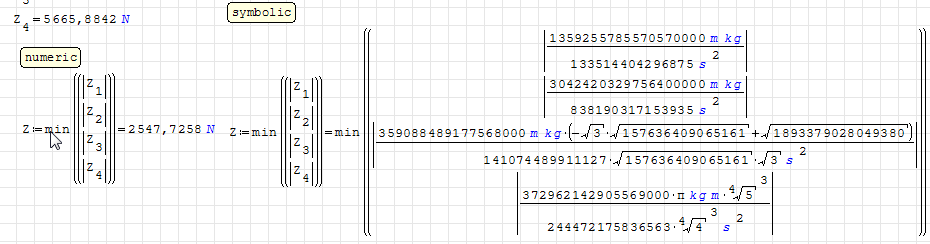

I have a small problem calculating a variable within a routine, that has worked before, but doesn't now..
Error is "units don't match".
When I look at the variables, the units are all the same.. don't see how I can trick the program into believing the this…

You can use eval()

The issue is related to the symbolic optimization. Switch the optimization of the definition to numeric to solve the issue.
About the attachments, check the button "Attach files to this post?" and click the POST button, you will be redirected to another page with a dialog to upload the files.
![2015-04-16 10_41_19-SMath Studio Desktop - [KP at rafters.sm_].png](/zh-Hans-CN/files/Download/Vod8NN/2015-04-16-10_41_19-SMath-Studio-Desktop---[KP-at-rafters.sm_].png)
