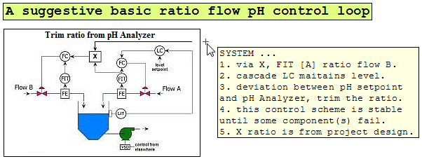

SMath Forum SMath Studio Samples pH Control Loop 1 Pages (2 items) pH Control Loop - pH Control Loop - Messages Go to last post #1 Posted: 2018/7/31 16:39:19 Jean Giraud 983 likes in 6,866 posts. Group: User This short study is just for lecture. Suggestive of how to tackle/conduct a real project.Thanks for the gracious companionship Smath/Maple.Enjoy/comment ... JeanInst_pH Model Titration.sm (68.74 KiB) downloaded 1106 time(s). #2 Posted: 2018/8/1 09:57:57 Jean Giraud 983 likes in 6,866 posts. Group: User ... balloon language added.... in-situ consideration added.Inst_pH Model Titration.sm (78.2 KiB) downloaded 975 time(s). 1 Pages (2 items) New Posts No New Posts
