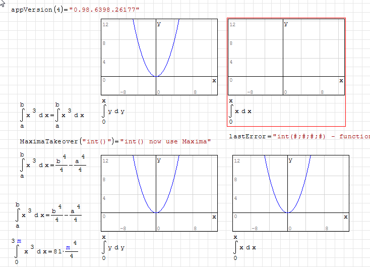

I am trying to solve the problem that I can't overwrite special functions in the Maxima plugin via the IPluginLowLevelEvaluation.ExpressionEvaluation interface, see SS-2401.
Obviously one can add definitions to the canvas from within a plugin function execution using something like this:
This replaces the built-in definition of int(4) with the one provided by the maxima plugin in the current downstream canvas.
The above solution was found by blindly poking around, assisted by the Core doc.

Thanks, Davide.
The include plugin has just one occurance of AddDefinition.
The idea is now to obtain the index of the definition using Store.Contains(Entry,Index) and remove it with RemoveAt()
As to the dependence on variable names: It was mitigated by also doing preprocessing for the integration variable in Int(4), otherwise parameter replacement didn't seem to work. Usually, the integration variable is just a dummy name and should not require preprocessing...
Is it sensible to use strange variable names like x__ in the definitions as it is sometimes on the canvas?

I implemented a new MaximaTakeover() function, which adds definitions to the context or removes them according to the given arguments. First tests seem very promising, such that the full functionality of the Maxima plugin can be re-established soon.
It turned out that something like
didn't do the job of deleting the definitions from the global context. The deletion actually worked (as per inspection in the debugger) but that was of only local scope. I had to resort to Clear().
int index;
if (context.Contains(lhs, out index) context.RemoveAt(index);

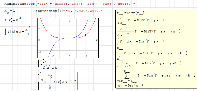

I'd like to provide a standard description to the definitions created in MaximaTakeover().
Currently, the descriptions simply show the definition (as can be seen in the previous post).
The idea is, to get the description of the Maxima function (Int(...) and add it as description to the generated definitions, perhaps with some adjustments (convert uppercase to lowercase in function names).
How would I do that?

You can use the AddDefinition(Definition value) method; Definition has some constructor with the description argument
Martin Kraska 2017/8/1 19:01:00
WroteYou can use the AddDefinition(Definition value) method; Definition has some constructor with the description argument
Thanks. Davide.
First, I tried a very compact way, but that didn't make it beyond the current math region.
// add definition
Entry rhs = Entry.Create(TermsConverter.ToTerms(Function));
context.AddDefinition(lhs, rhs);
// add description
context[context.Count-1].Description = "description of "+ LhsString ;
Then I used the approach proposed by you, unfortunately, the definition constructor requires a terms list to specify the arguments. I found no smart way to extract this list from the function definition strings. Thus the code looks ugly and bloated.
string name = LhsString.Split('('
[0];
string[] vars = Regex.Replace(LhsString, @".+\((.+)\)", "$1"
.Split(','
Term[] Tvars = new Term[1];
int i = 0;
foreach (string v in vars)
Tvars[i] = new Term(v, TermType.Operand, 0); i++;
context.AddDefinition(new Definition(name, Tvars, rhs, "description of "+name));
This approach didn't work either, I even could not see the descriptions being generated at all in the debugger.
And in the end, when trying to provide a description in a math region directly, this is ignored. For the moment I have to give up. This might be related to the target functions being special functions. Re-definition somehow slips through, re-description obviously not.
![2017-08-02 00_50_20-SMath Studio 0.98.6398 - [Takeovertest1.sm_].png](/zh-Hans-CN/files/Download/24KbNC/2017-08-02-00_50_20-SMath-Studio-0.98.6398---[Takeovertest1.sm_].png)
Hello Martin,
Confirmed. I've looked at the core code and I know why, I'll try to make ii possible.
WroteThis approach didn't work either, I even could not see the descriptions being generated at all in the debugger.
WroteConfirmed. I've looked at the core code and I know why, I'll try to make ii possible.
Sounds promising. There is more to report.
This guy isn't just useless, it is also dangerous. It sweeps all but one signature variants for each function off the context. Just the versions with a single argument survive this seemingly harmless line of code.
BTW, working with the debugger and observing how the context changes during function calls provides great insight into how SMath works. It's real fun!
