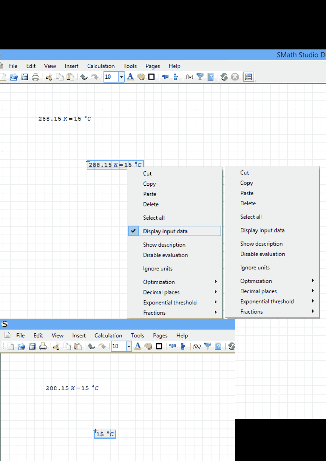

Currently, the custom units of result placeholder has scope of whole expression. So, e.g. trying to select result (15°C) in following line:
288.15*'K=15@'°C
results in whole expression being selected, not only part after "=".
If possible, please enable that selection, to make it easy to copy only result.

#2 Posted: 2016/5/19 09:24:02
copy only result.
Maybe like this Mike.

#3 Posted: 2016/5/19 12:50:48
2,326 likes in 4,013 posts.
Jean, I think Mike requests something like this:
Will check if it is possible to implement

#4 Posted: 2016/5/19 13:31:19
CBG
CBG
78 likes in 312 posts.
Or something like this..

#5 Posted: 2016/5/19 19:02:30
Implemented. Can be tested here: http://en.smath.info/forum/yaf_postst7566_SMath-Studio-0-98-5983--19-May-2016.aspx
