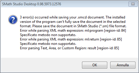

In the method
public static Term[] PrefixToPostfix(Term[] value)
I found that an exeption is thrown while parsing the UnitOperator; skipping this (that is just a workaround, there's an inconsistence to fix somewhere), it loads more functions but there are some errors in the last 2 xmcd regions (unrecognized tags ml:program and ml:return)
The patch on the UnitOperator seems that helps even here: http://en.smath.info/forum/yaf_postsm33083_Mathcad-file-import.aspx#post33083 (still missing the conversion for the "plot" region)
Reported as SS-2341

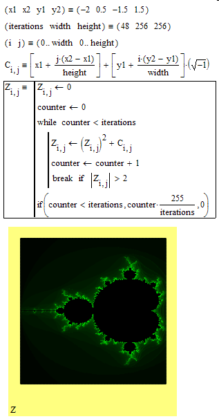

The attached image is Mathcad 11. Should be same in Mathcad 15, easy for 15 users.
Once in Mathcad 15 by some Smath users, then attempt to "convert" Smath.
In Mathcad 11: independent of ORIGIN 0 or 1. The plot is matrix in any color, in Smath
it will be grayscale unless Alex can make it RGB.
Something simple to crunch for you collabs asking for Mathcad 15 => Smath conversion.
Hope to read feedback ... Jean

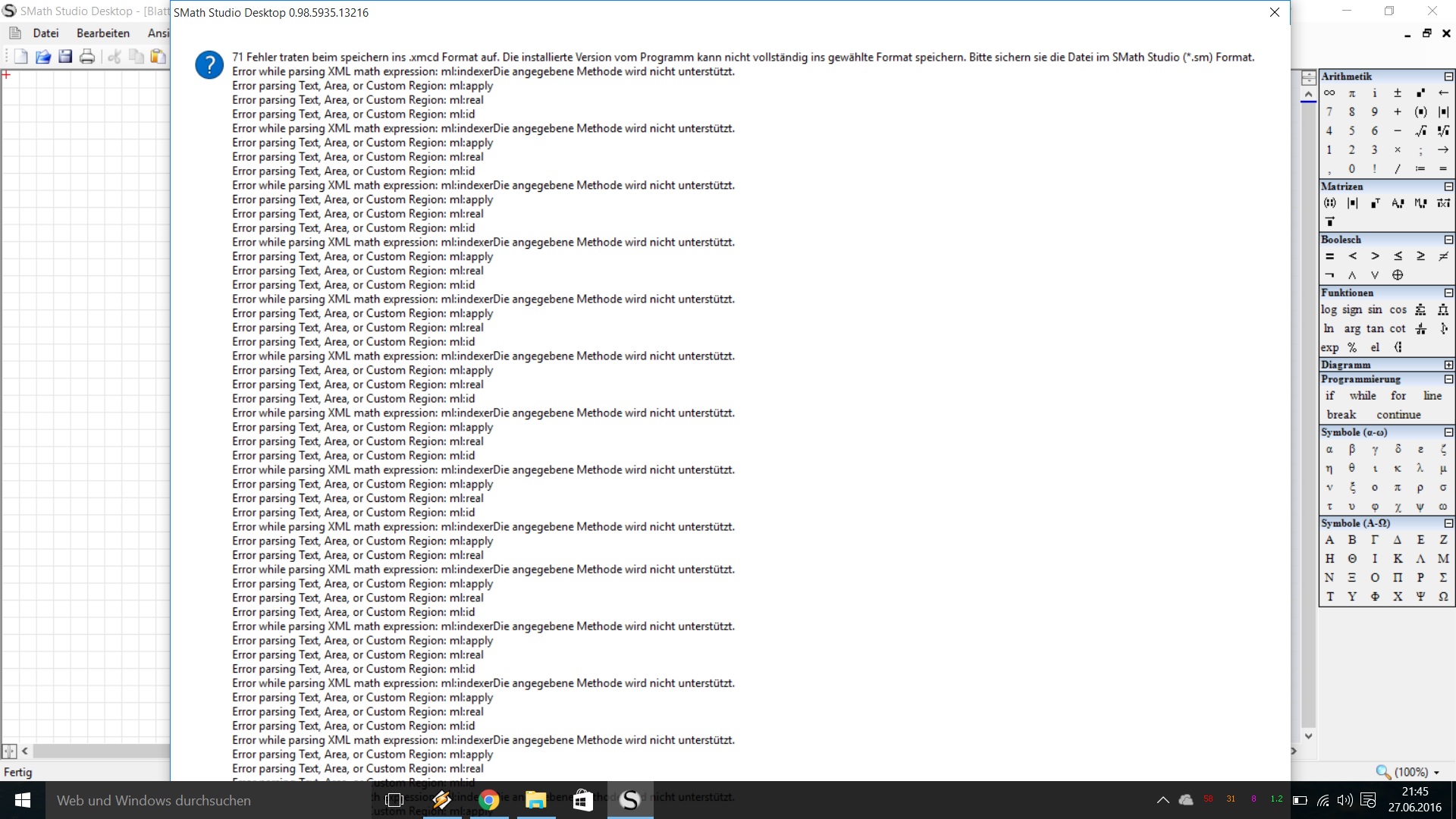

#9 Posted: 2016/6/27 16:47:27
Stefan Müller
Stefan Müller
0 likes in 45 posts.
Anyone has an answer?
Thx
edit: Screenshot of the error message
Show Spoiler
please don't delete any post if it contains bug infos
#10 Posted: 2016/6/27 19:42:13
1,441 likes in 2,932 posts.
These are other missing attributes from the xmcd schema. Moved your question here since it is the same issue (about other elements).
